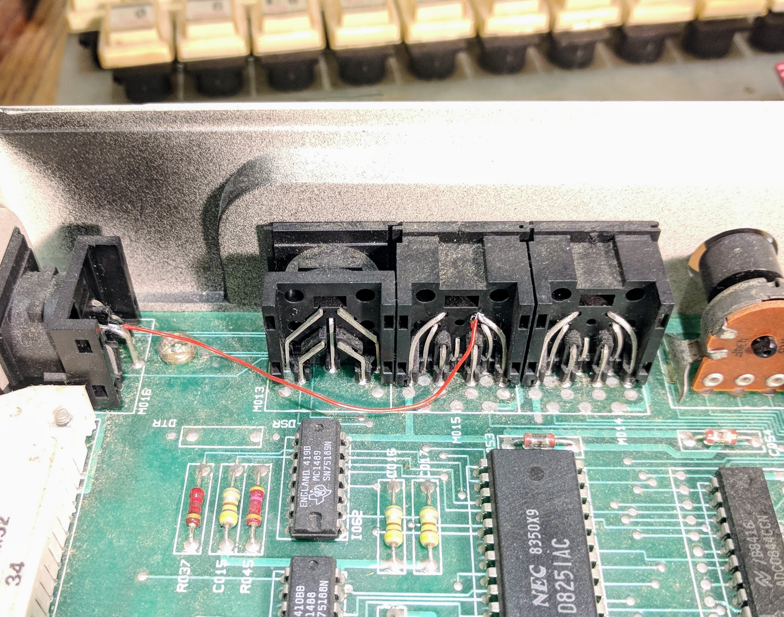

I have a TC-01 on the way! From what I've read on line, I take it I can use a BBC scart cable, but I have to switch the internal jumper to RGB, and also connect a +5 line to the center pin of the video socket? Can you take it from the +5 on the floppy for example? Any pics of that mod?

I made that mod, took the 5V from an adjoining socket which is the joystick IIRC. Do you like the 'dust' filter? :lol:

I'm guessing that the +5 is for the rgb switch on the TV?
Re: RGB Scart Lead for TC-01
I presume so, it didn't work without it.

sirmorris wrote: Thu Oct 24, 2019 1:28 pm I made that mod, took the 5V from an adjoining socket which is the joystick IIRC. I'll edit & attach a photo to this post later.
Have you got a piccy yet please? :) I’m raring to go :lol:

Sorry, been a little ... pre-occupied. Done now!

Oooh, thanks! I’ll give that a go! I had it working via rf on an old lcd tv last night :D
I've rigged up a lead and using a BBC Scart cable but no luck :( I get a brief rolling picture of the Einstein then a black screen.
I can't use my BBC cable as it has resistors in ... I use my Atom cable which doesn't. I wonder if this makes a difference for you too?
