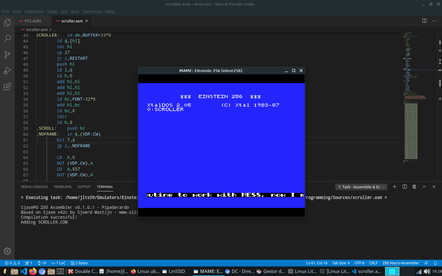

It works!...after some fixes...
Seems that with my Linux (yes, this time I'm using Linux) setup has some compatibility problems with the sources of dsktool and I've been forced to make some changes.
I'm using latest Linux Mint (Ubuntu Bionic based) with x64 GCC 7.5.0 and seems that the support of C++17 features is limited; so I've changed some things to turn it into a compilable tool.
Next, using it as part of a VSCode task I've created a handy toolchain to work with assembler files:
I can launch a TC01 or TCS256 emulation at will.
Now I need to find a way to autoexecute a .COM file when booting a disk and I'll be happy forever :D

In the meanwhile, as it's only to finish the toolchain with an autoexecution, I've used a MAME feature and added some autoboot commands to autoexecute my compiled program:
Code: Select all
-autoboot_delay 4 -autoboot_command "PROG\n"
The above parameters make MAME to wait 4 seconds and then, auto-type PROG+ENTER to run PROG.
Good enough!
