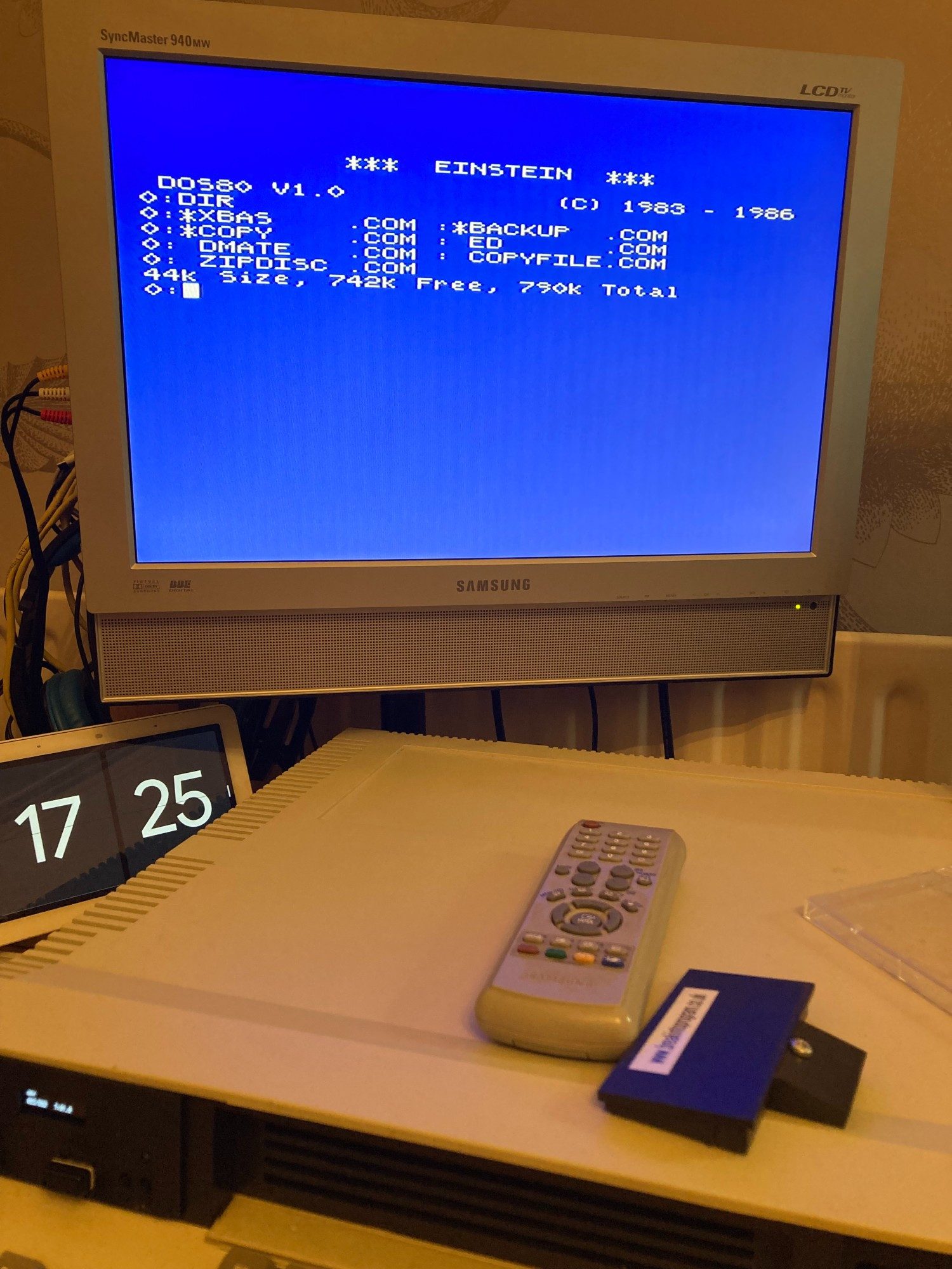

Gotek 800k disc images!
Re: Gotek 800k disc images!
Great stuff, Lardo :D
Worth posting a reminder that the disc in Drive 0 determines how the format of each drive is recognised by the system. So this disc image will be fine in a Gotek designated as Drive 0.
Anyone wishing to use this image in a Gotek designated as Drive 1 will need to update their DOS80 boot disc in Drive 0 to take advantage of 800k in Drive 1. Remember to save the updated DOS to Drive 0 when using CONFIG.
The system looks to the DOS tracks in Drive 0 for the format configuration of all four drives, not the discs themselves!
