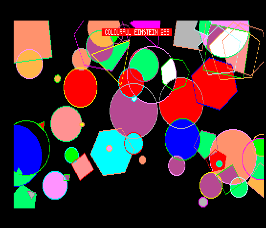

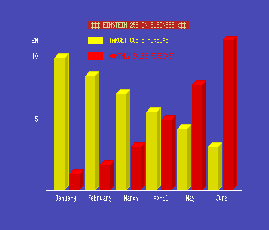

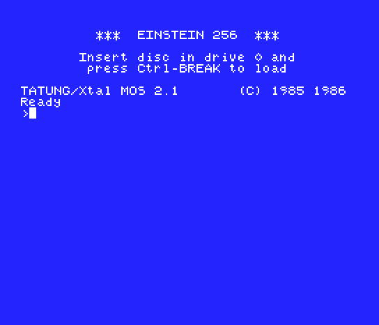

The Einstein is surprisingly only emulated in MAME. The TC01 has been emulated for many years but was not until very recently that the ROM from an Einstein 256 was dumped, and made available to emulate.
Here are some screenshots from the current Einstein 256 emulation:
