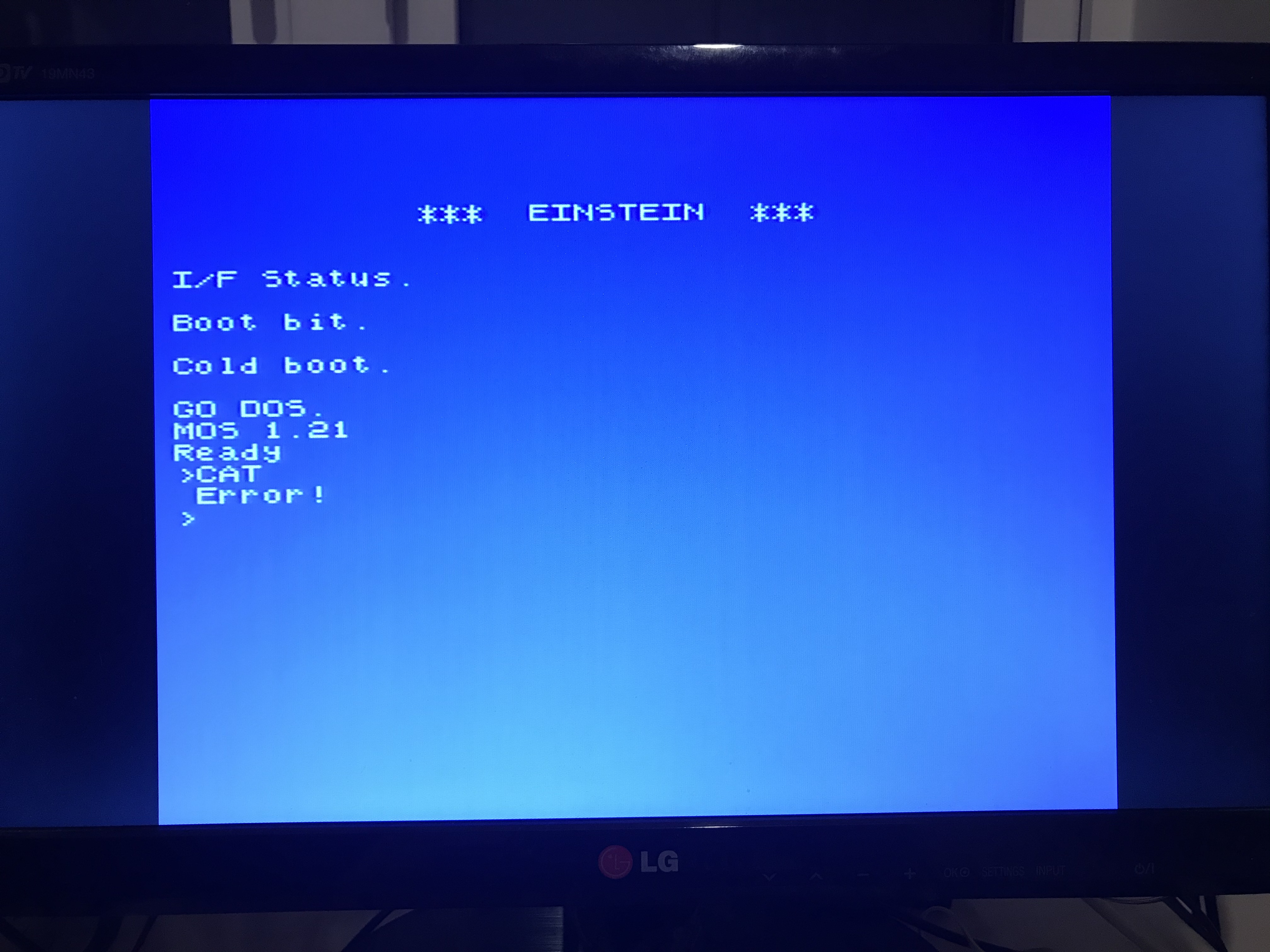

Sometimes when I switch on I get this:

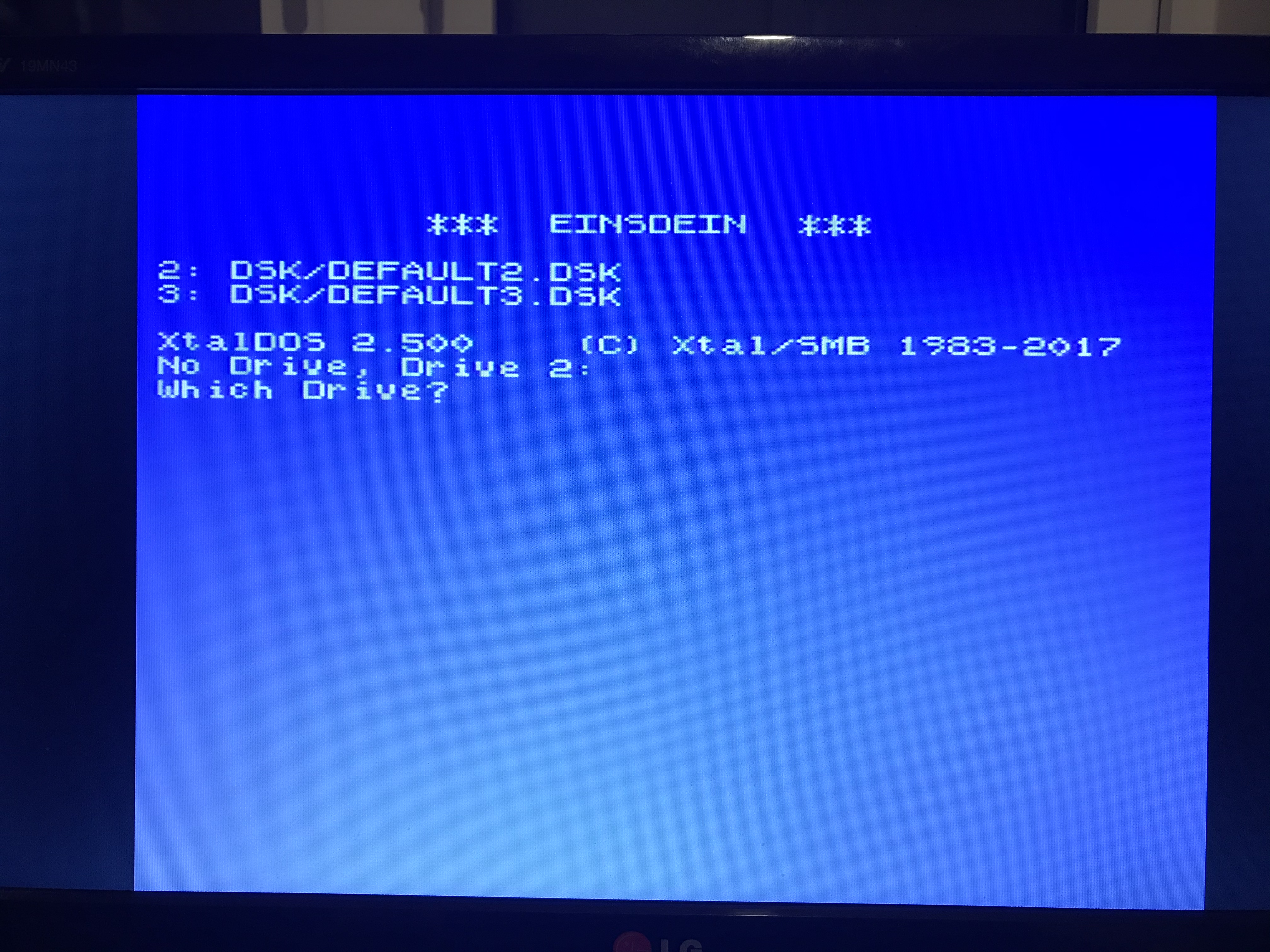

Sometimes when I get a no discs in drive 2 or 3 error:

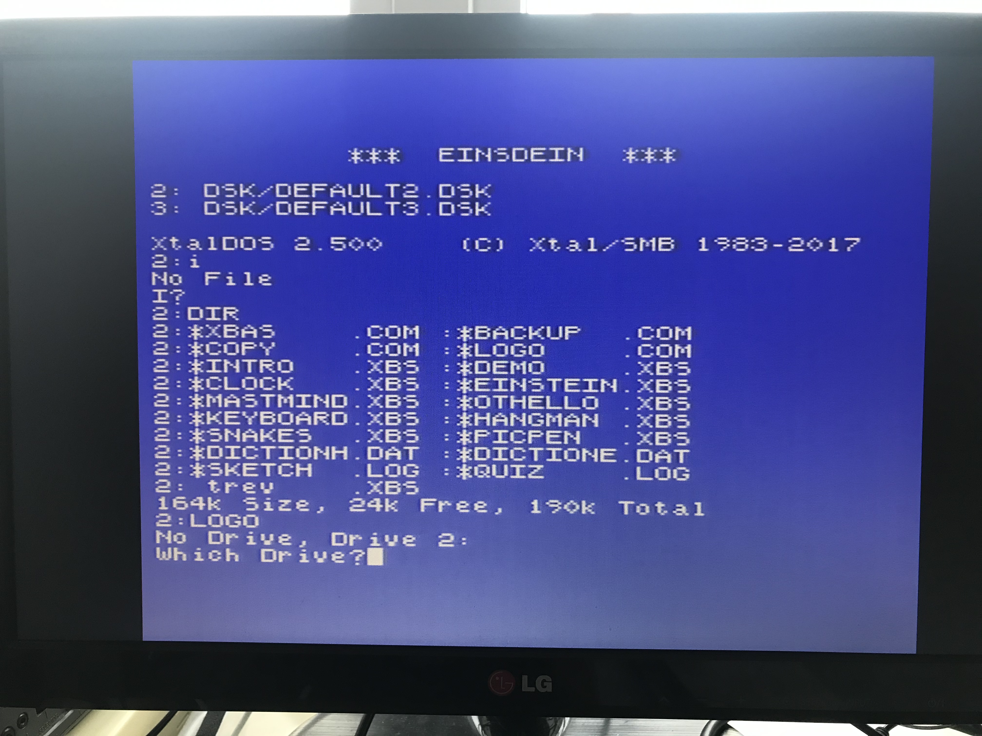

Sometimes it works and does DIR (keyboard permitting) and then fails:
I have cleaned the PIPE pins a couple of times.
So presumably it either doesn’t like the SD card or my flaky tatty?

I get this too, I reckon my Tatty is well flakey :(

It looks remarkably like the symptoms that Mr. vanpeebles has been seeing. It'll be interesting to see how his z80 transplant goes. I don't think this is an SD card issue. If you're worried that it's a defective board then I'll be happy to re-test it for you. I don't think it is though, as I had vanpeeble's board back for testing and it checked out fine :? Out of curiosity is your einsdein ROM an EEPROM (no window) type or a regular EPROM?

I doubt it is the board as well.
Mine has an EPROM I believe (with a little bit of sticker covering the window).
When the keyboard works I can load some games (depending on the file name / keys working at the time) from floppy disc and they happily run.
Could it be a similar issue to Spectrums and the Z80 where stuff like the DIVMMC doesn’t work?

Tried sd setup in new tatung, worked perfect first time, then fell over ever since, doing the same no drive, which drive :(
Re: Keyboard troubles
Posted: Sun Jan 19, 2020 11:50 am
by vanpeebles
No hex errors like first tc01, just endless no drive, which drive, indentical to lardo.
