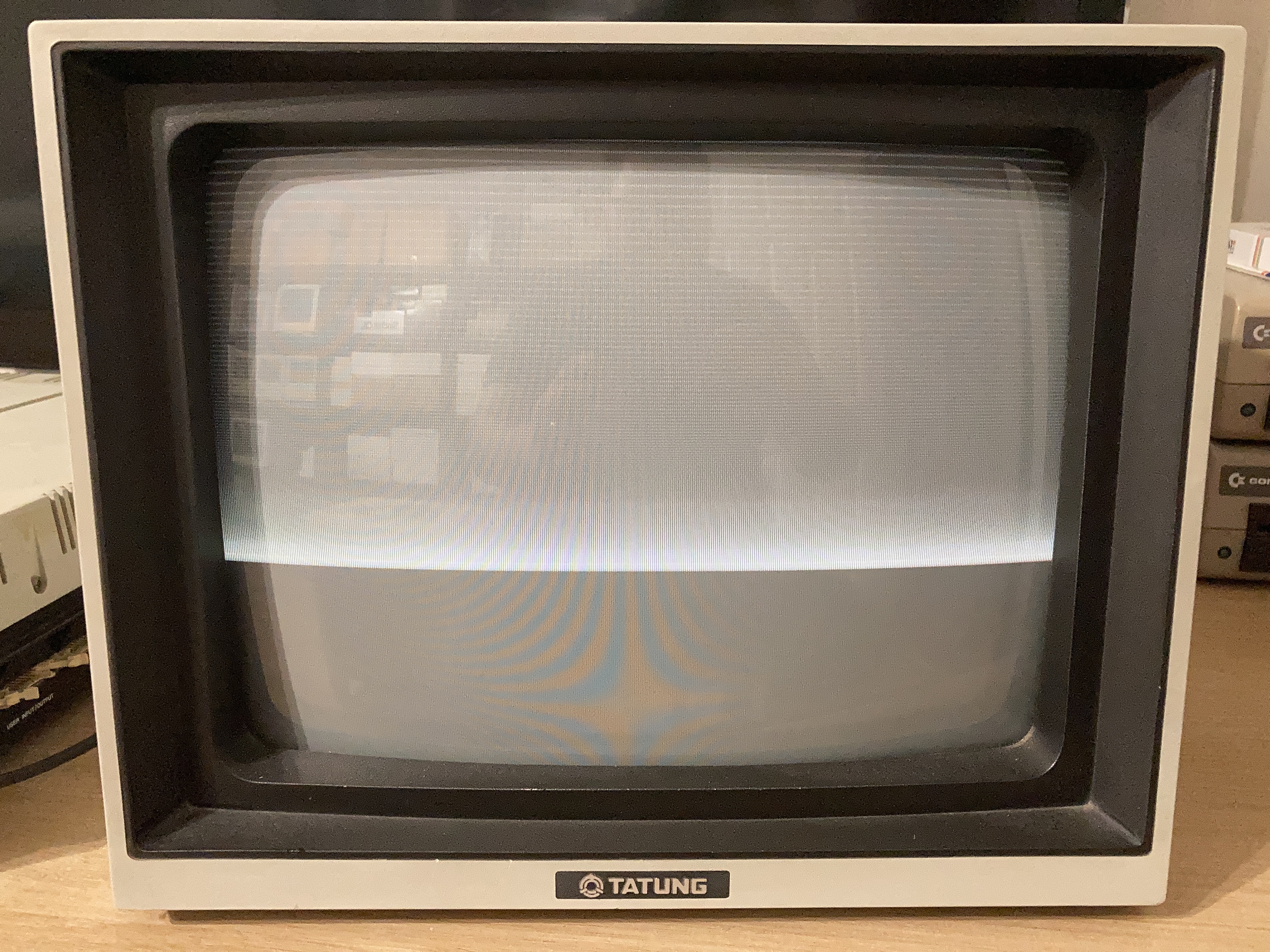

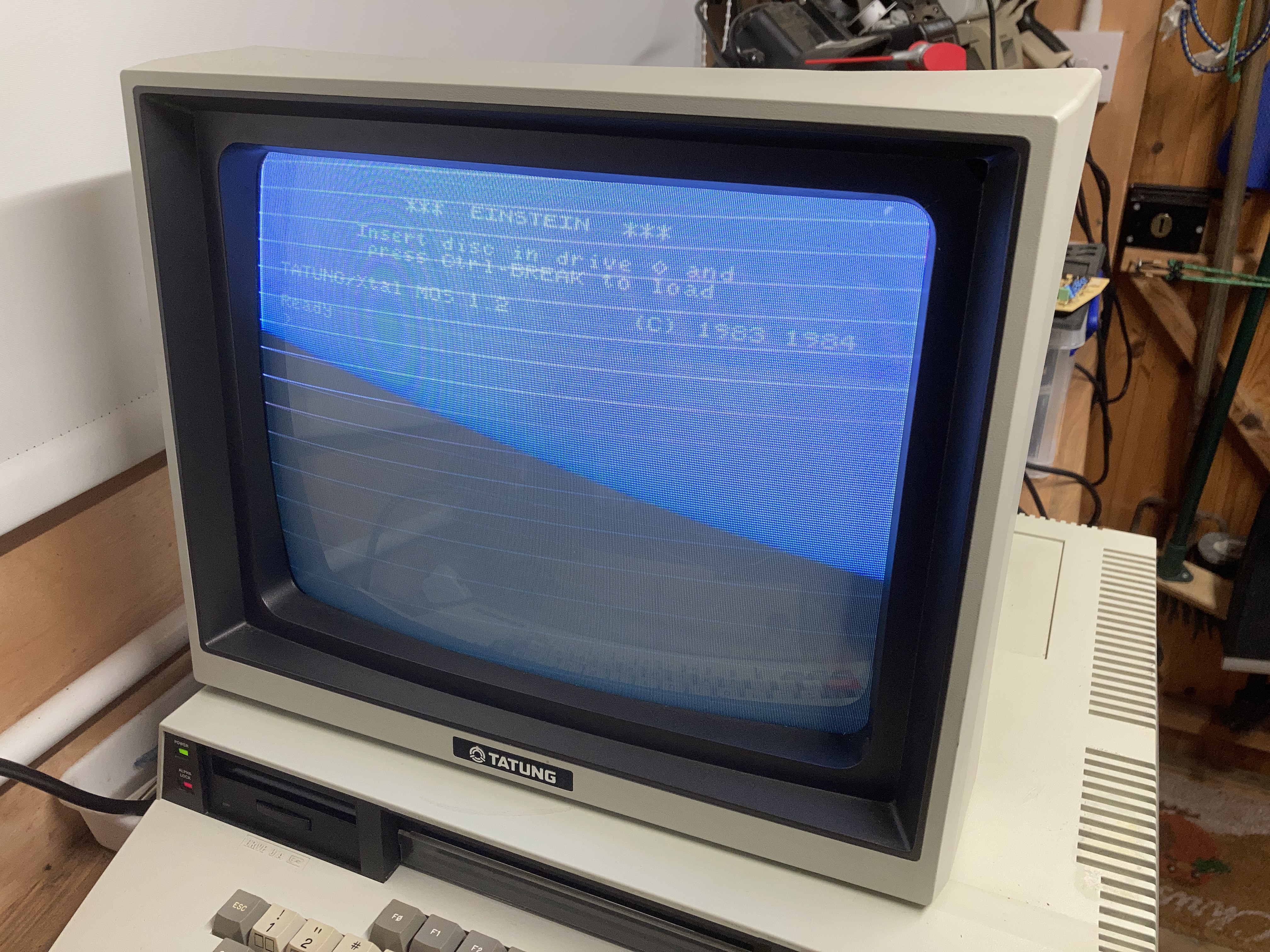

I've got a Tatung Einstein TC-01 and a matching TM-01 CRT display in for repair - the computer was a black screen fault which I've repaired (bad system RAM), and the display has vertical deflection issues - see pictures below.

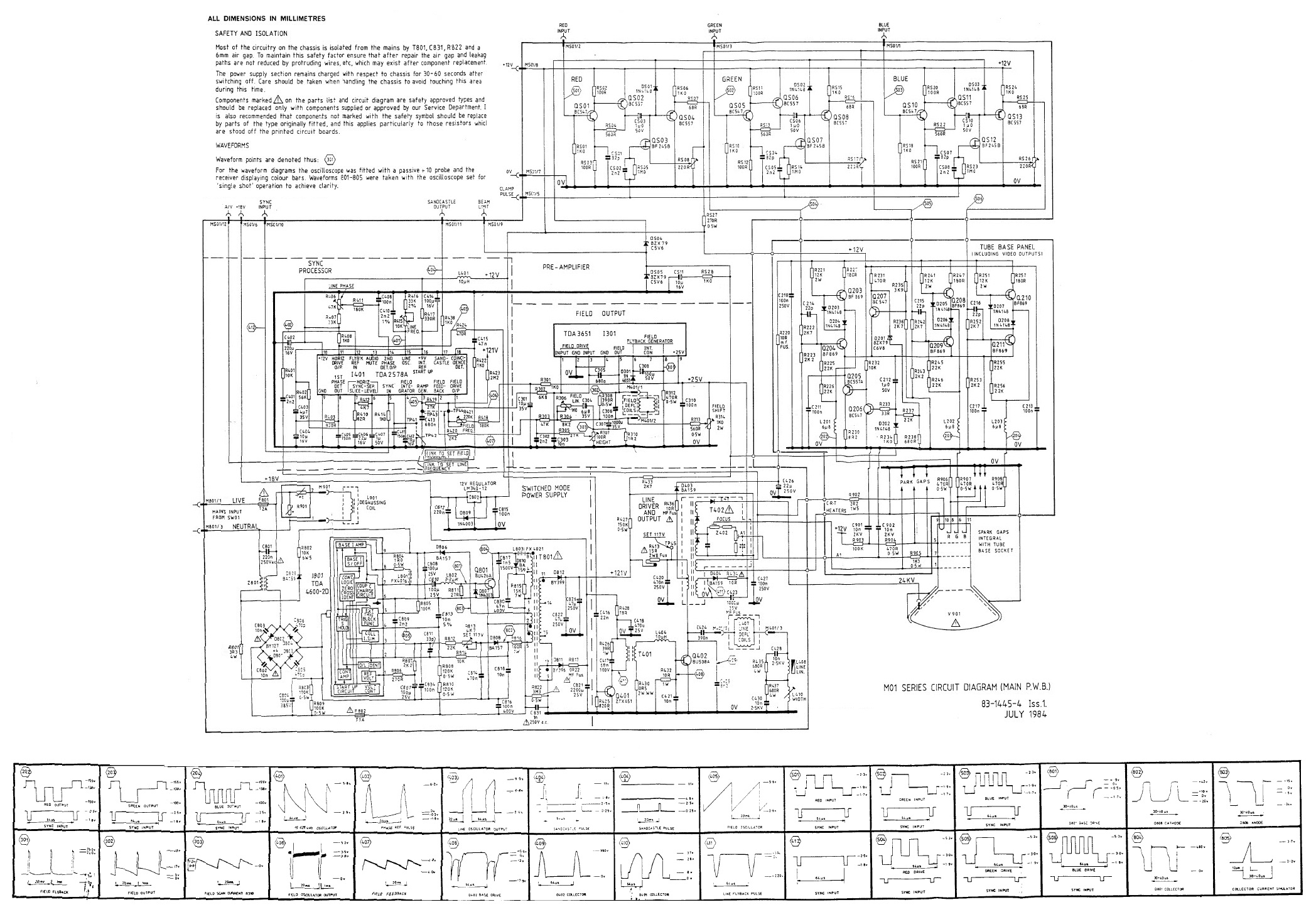

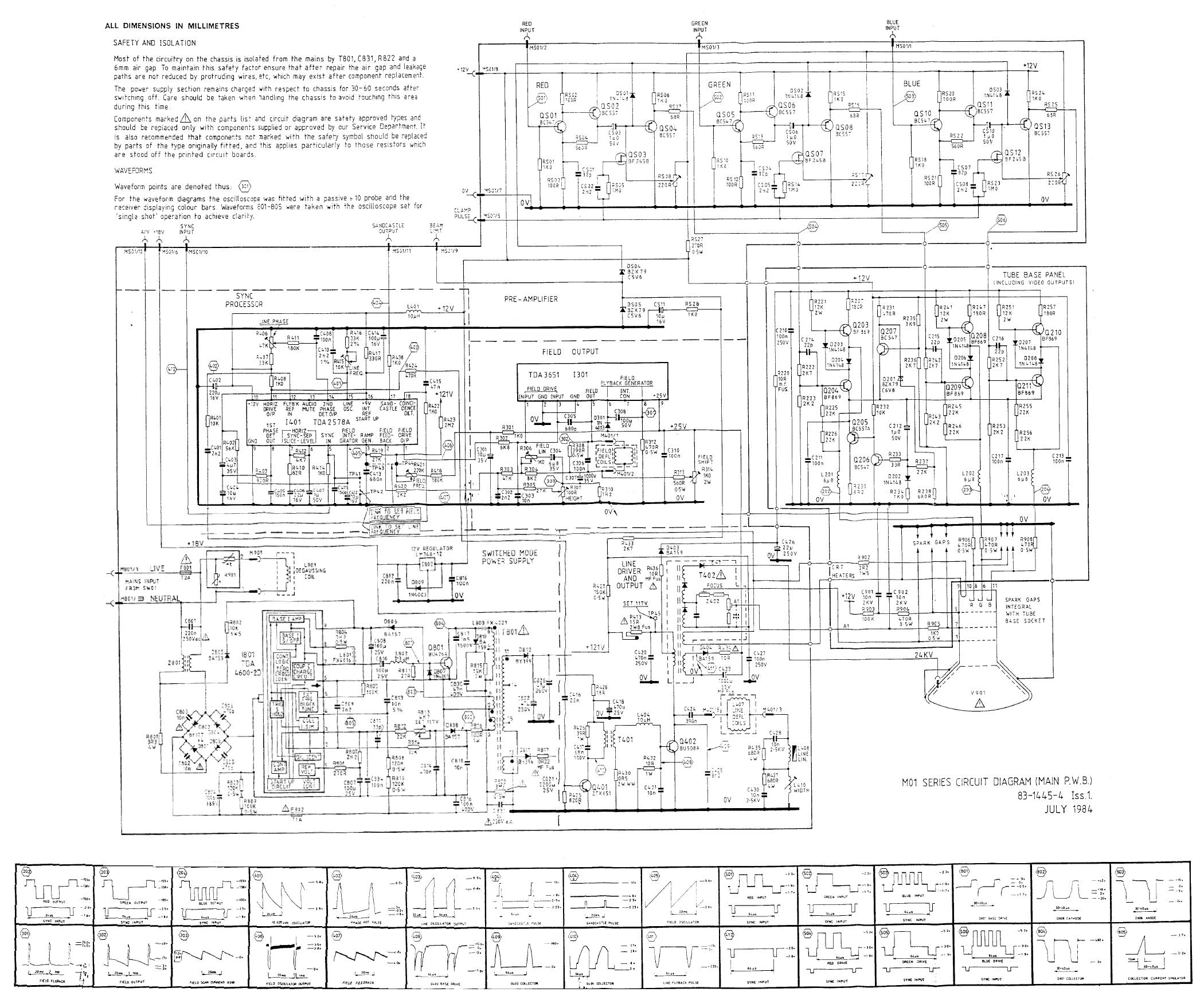

I've put a schematic together from the service manual:
Tatung Display TM01 Schematic.PNG (653.13 KiB) Viewed 78785 times

I've managed to fix the vertical deflection issue - several potentiometers were dirty/bad, primarily the height potentiometer, and there were a lot of bad solder joints on the mainboard, particularly on the larger power resistors.
So, I now get a recognisable image with the full height of the display.
However, I have two issues remaining:
#1: the raster is very intense and noticeable, even with the HV on the flyback transformer turned to its minimum.

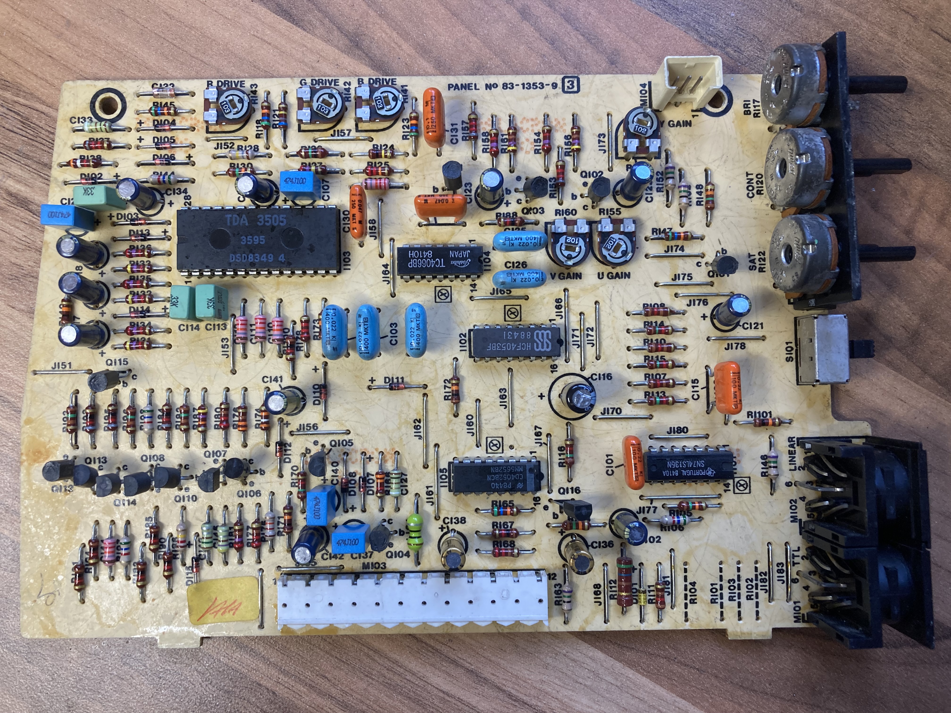

I've done some testing with a known-good display, and issue #1 is definitely a problem with the mainboard, while issue #2 is definitely a problem with the daughterboard.
The daughterboard has been recapped, and I've visually checked it carefully against the known-good daughterboard that I have.
The colour control potentiometer has been cleaned and tests OK.
I can't find service information for the daughterboard, but it seems to be based on the reference design for the TDA3505.
The RGB potentiometers all seem to be OK, but I'll double-check them.

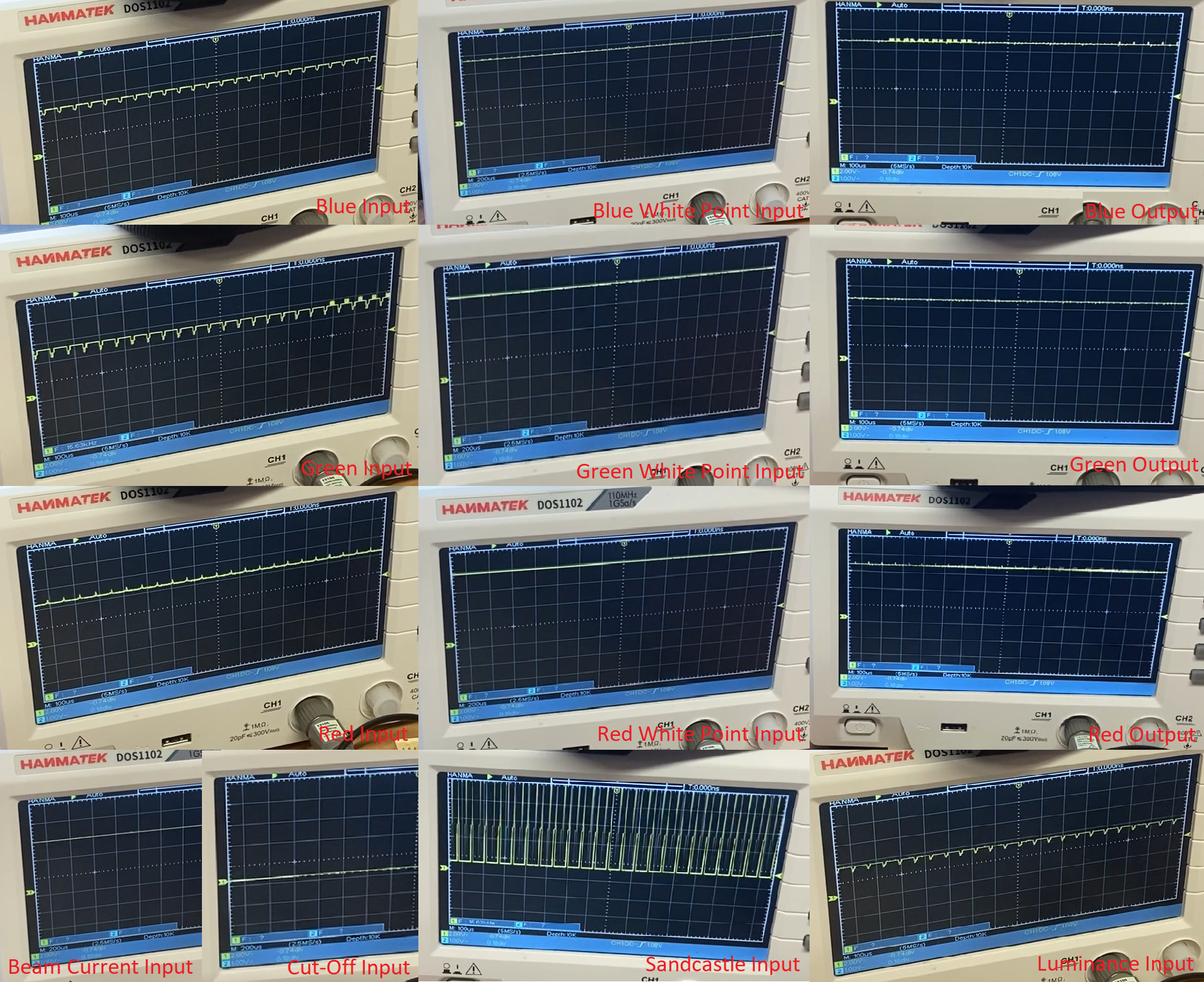

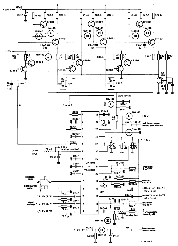

In addition to this, I've attached a schematic that I've put together for the TM01 (from the service manual), the schematic for the TDA3505 reference design (from the datasheet), and oscilliscope traces from some of the major TDA3505 I/O that I've taken on the bad daughterboard.
Tatung Display TM01 Schematic (b).jpg (818.31 KiB) Viewed 78319 times
TDA3505 Reference Design.PNG (125.27 KiB) Viewed 78319 times

Well done Adam in getting your monitor very nearly perfect.
For issue #1, is the problem the frame retrace not blanking? See
http://easkcom.blogspot.com/2012/05/why ... occur.html
for descriptions of the problem. Can then look for possible causes.

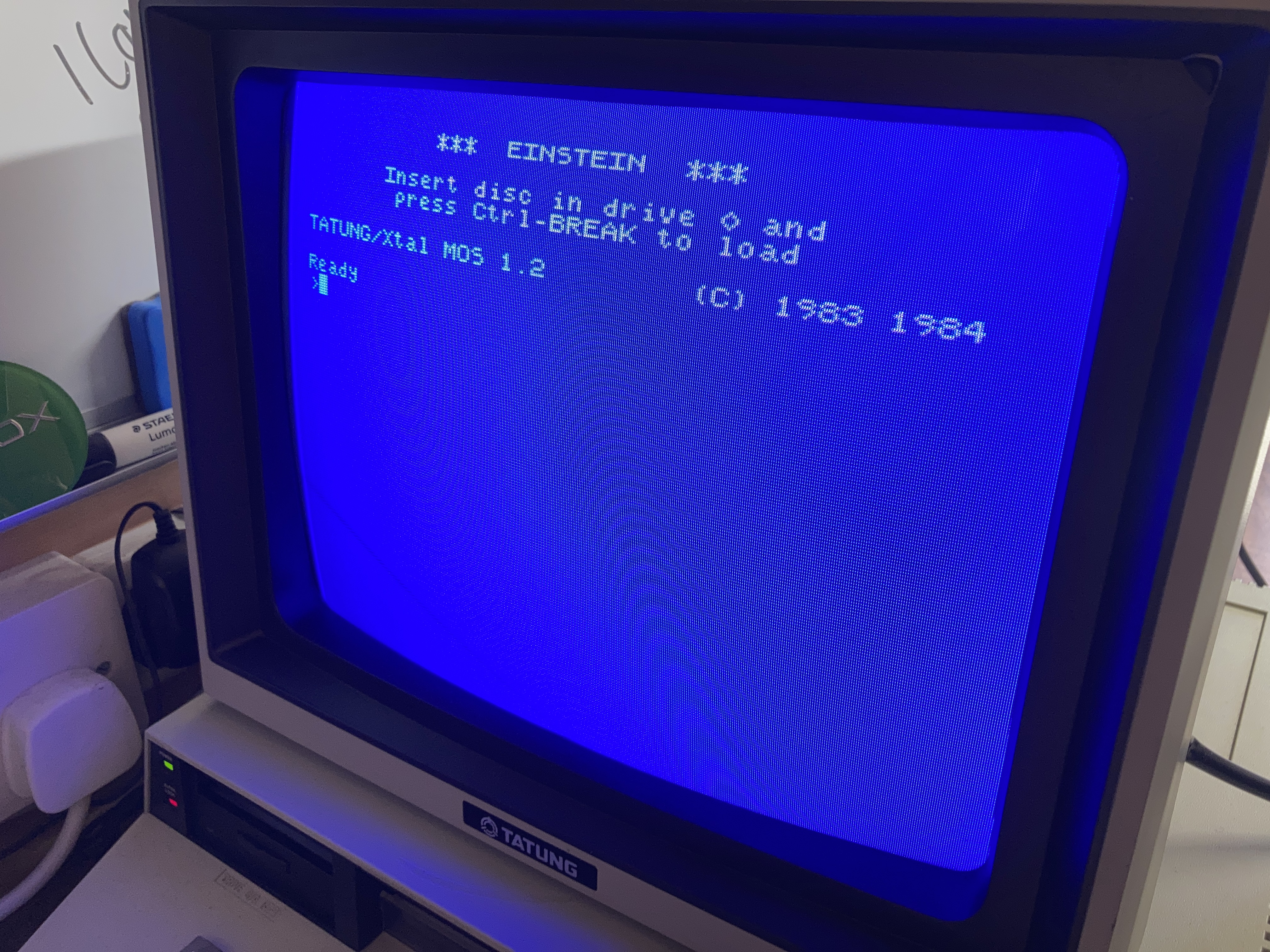

I've managed to make some progress since I last posted - the colour issue with the daughterboard was due to R155 (U gain potentiometer) being open-circuit, replacing it with a new 1kR potentiometer brought colour back on TTL.
I'm still getting the bright vertical lines, the screen is extremely bright, and the screen voltage seems very high (I get retrace lines even with the HT voltage on the flyback transformer at its minimum, and there's very little increase before the image blows out). Adjusting the potentiometers on the mainboard doesn't make any difference. Could the flyback transformer itself be the issue? Is there anything else in the schematic that could be an obvious cause of this problem?

Hi all,
I can answer my own question here!

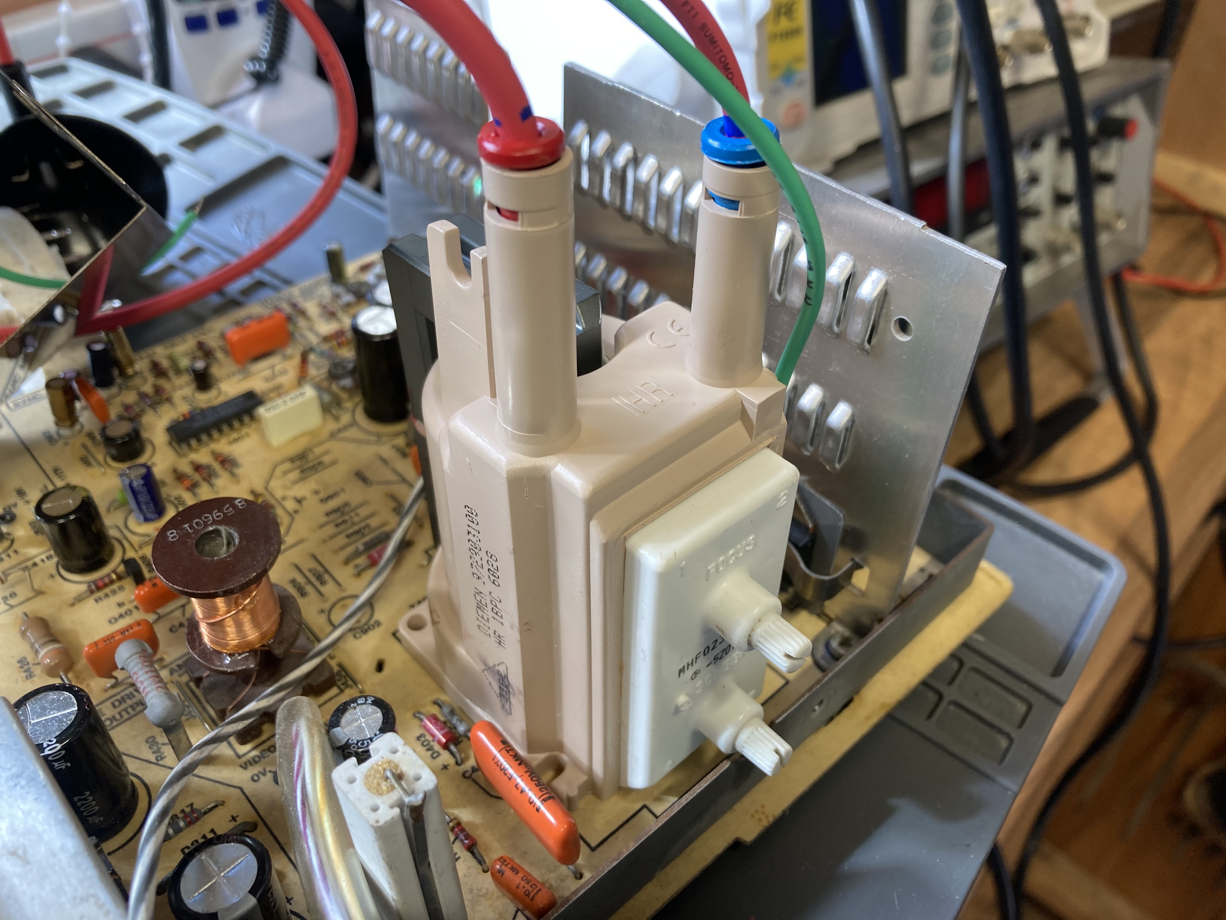

I decided to try and replace the flyback. The fitted part seems to be an Orega 37013 marked "01 SD C0" which I couldn't find any hits for. The TM-01 service manual says the recommended part number is a Tatung 85-3878-6, and according to Donberg Electronics the replacement part for this is a HR 6028 - the order link for this is below.
https://www.donberg.ie/descript/h/hr_6028.htm

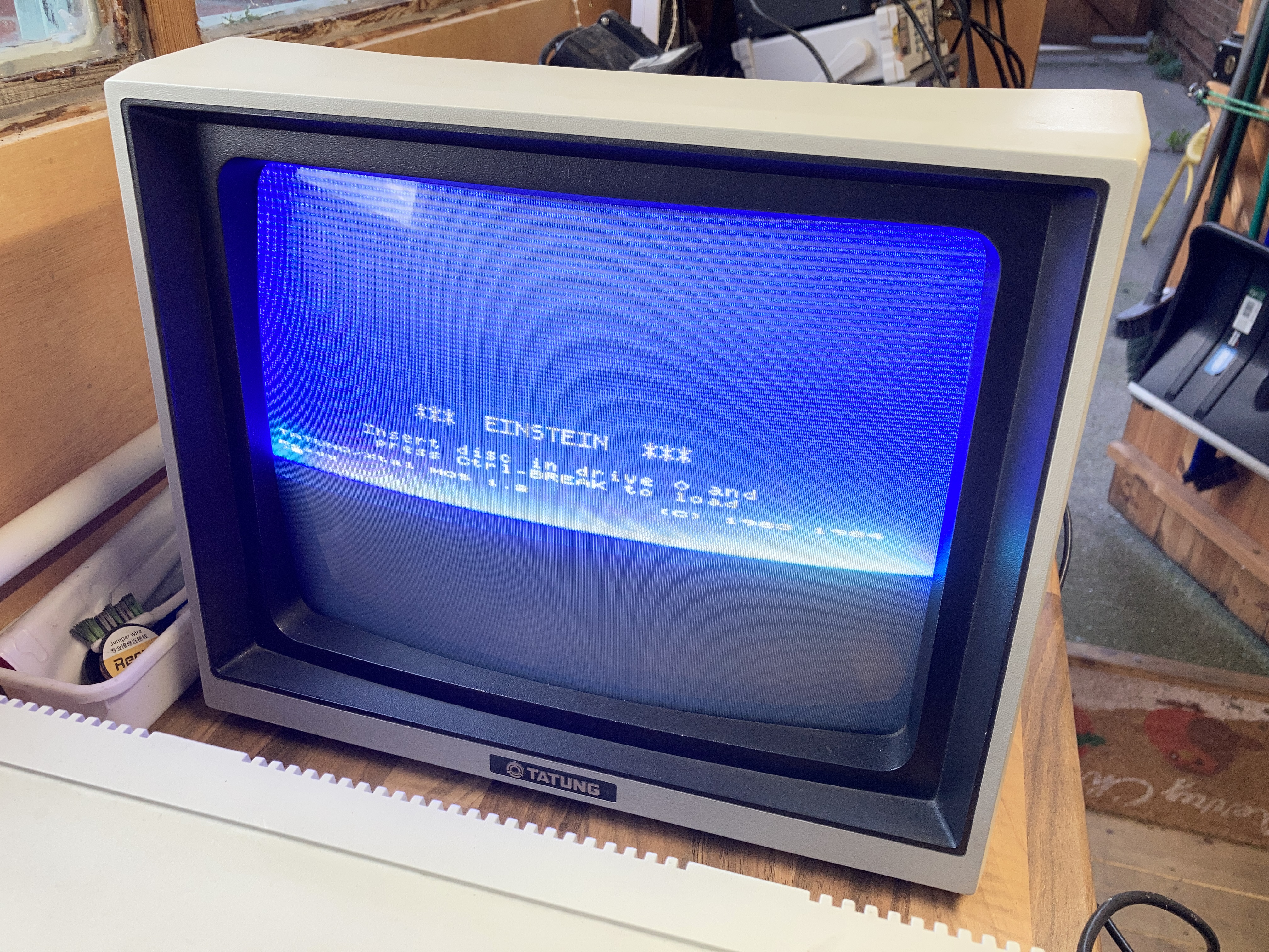

I removed the old part and fitted the new one, which included removing the CRT neck socket from the neckboard to replace the screen cable (there is a white cover which pops off, and the cable is soldered inside), and the display seems to work just fine now!
