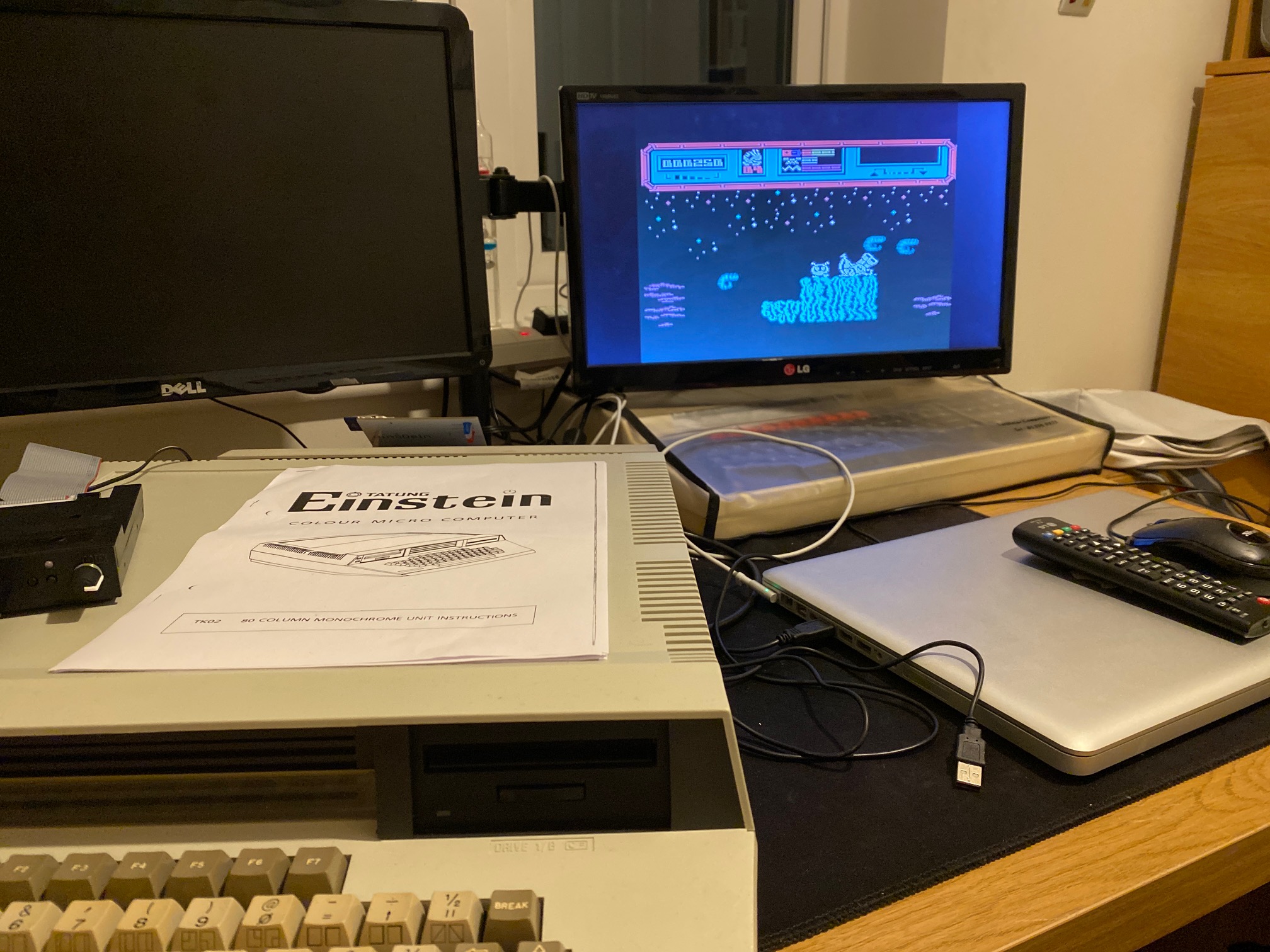

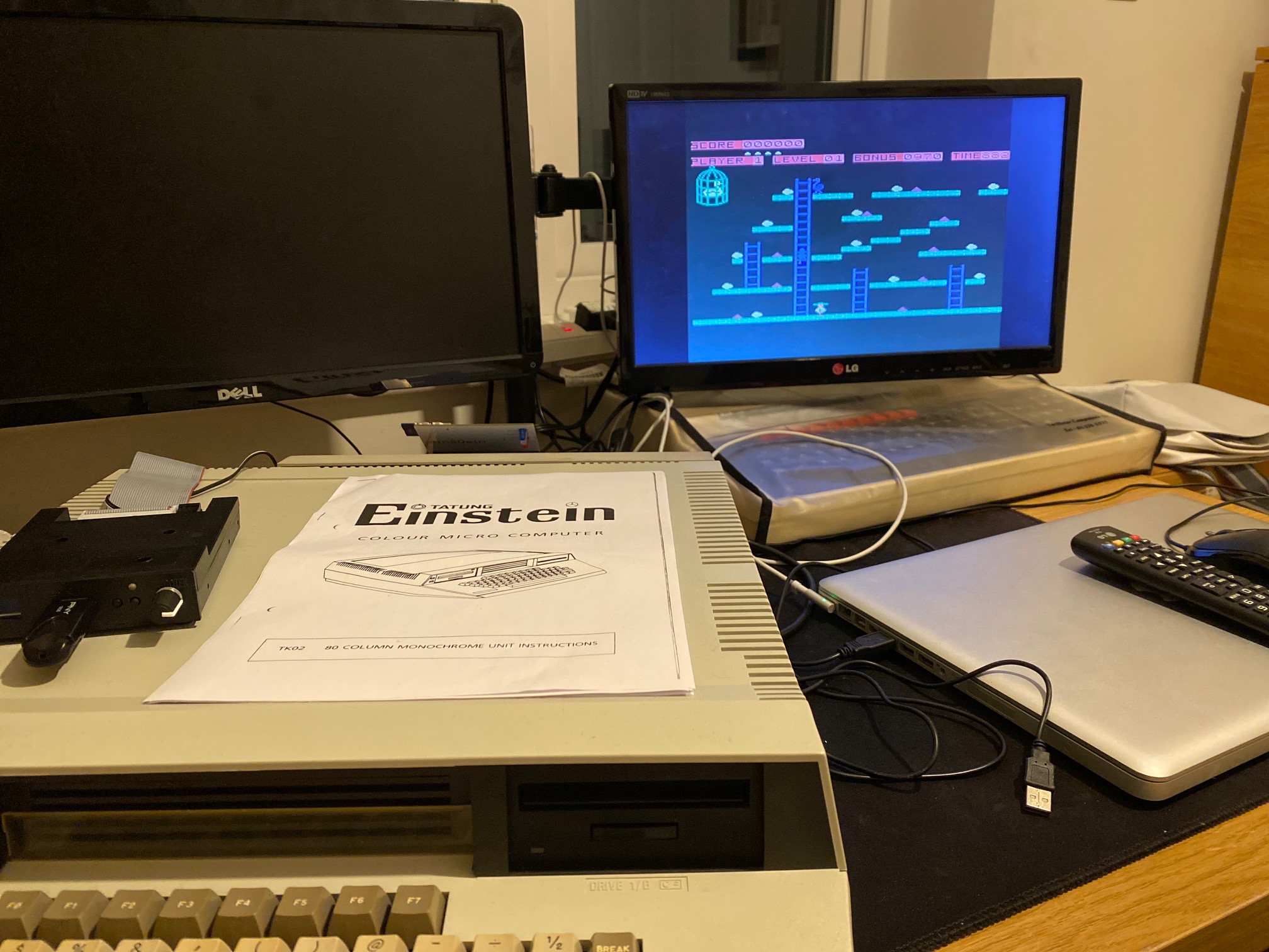

Lardo Boffin wrote: Thu Dec 31, 2020 10:42 pm I *think* I have a solution for my problems although I don’t have an explanation as to why it works. :shock:
I got an 80 column card today and when plugged into the back of it my einSDein works fine and continued to do so for about 10 mins of testing.
Somehow the 80 column card being in between the TC01 and einSDein seems to stop whatever issue was arising.
Any explanations as to why would be of great interest!
Amazing scenes!
Re: einSDein troubleshooting
Posted: Fri Jan 01, 2021 8:03 am
by Lardo Boffin
All loaded from the einSDein!
Starquake:
Chuckie egg:

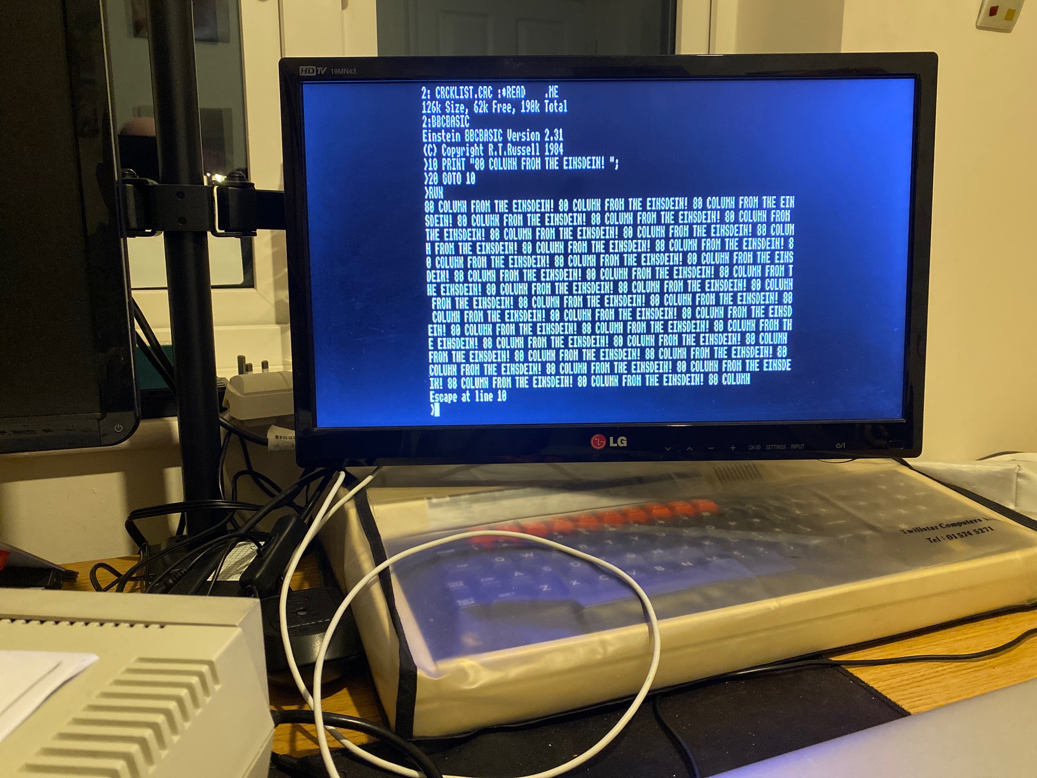

And BBC BASIC:
Which impressively seems to be ok with 80 column mode ‘out of the box’!
