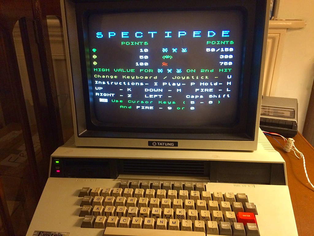

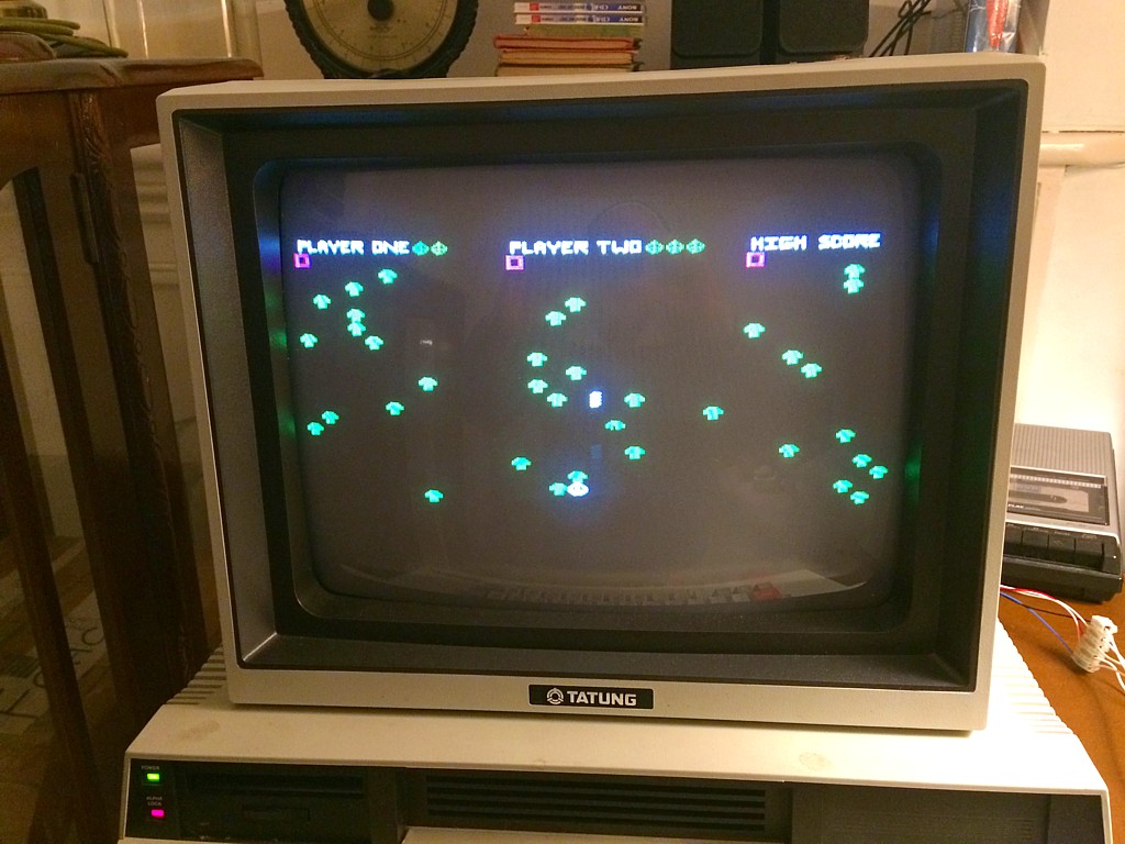

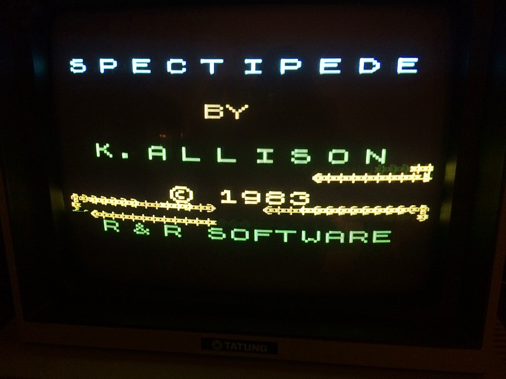

I sold all my Spectrum tapes bar one years ago, which means I can load only one game with the Speculator - and it works!
A few of the Einstein's keys are sticky and CTRL doesn't work. Colours are washed out in the photos but monitor picture is amazingly vivid with minimum brightness and maximum contrast. You can see my original 1980s custom serial cable on the right and I'll test whether this can run at 57600 bps a bit later.
