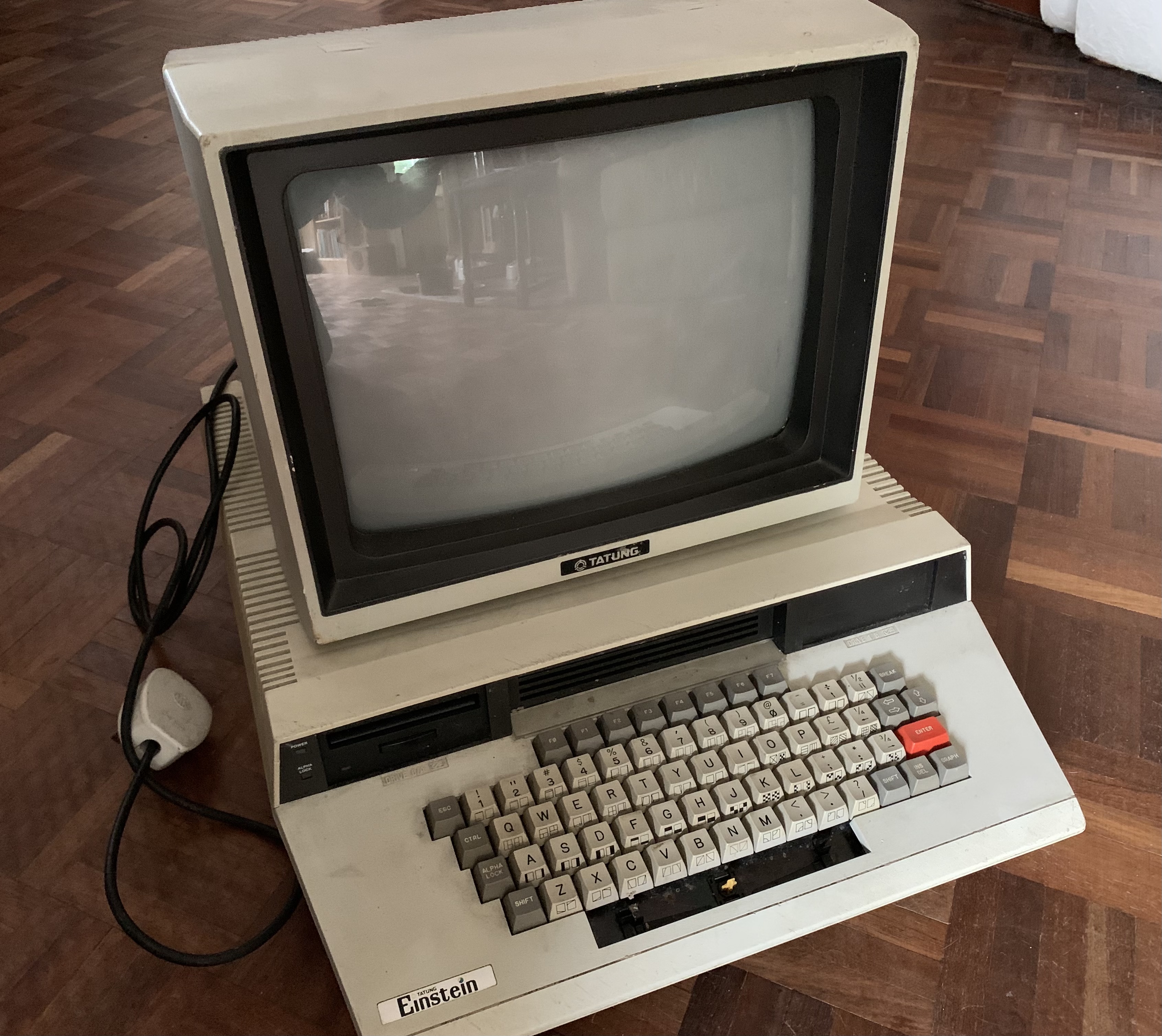

Here she is, missing the spacebar unfortunately but for £55 this was worth the trip :mrgreen: next job is see what works.

Shame, I need to keep an eye out for a spacebar.
The TC01 seems to work absolutely fine and the monitor has glow so there's good signs it might work ok, will see once i've sorted out a cable for it

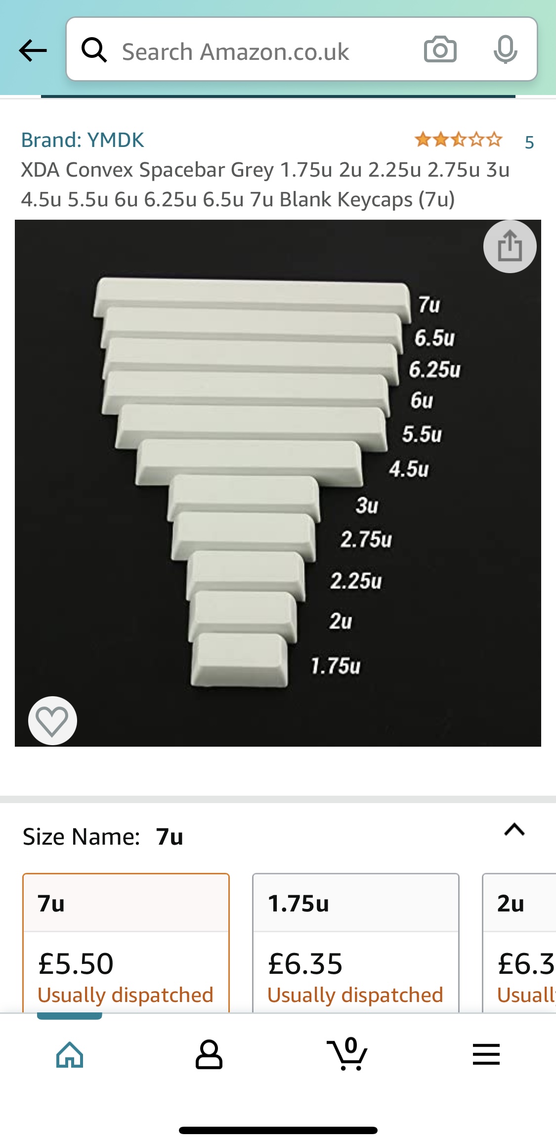

The spacebar might be one for the 3d printers :)
Re: TC01 for sale
vanpeebles wrote: Tue Jul 06, 2021 7:45 am The spacebar might be one for the 3d printers :)
Interesting thought :) i'll look into that. Doesn't seem to be the same size as any of the modern ones you can buy or any of the other old computers i have around here
Re: TC01 for sale
Yes, it seems fairly easy to get hold of a standard 6.25u spacebar. It looks like the Einstein needs an 8u.
I've seen references to 7u, 8u and even 9u so it might be possible to source a replacement ...
Re: TC01 for sale
Every size but…
Apparently each #u is 19.05mm.
Re: TC01 for sale
Useful to know. Looks like an 8u spacebar will be slightly too large anyway as the Einstein spacebar is 150mm.
8 * 19.05mm = 152.40mm
7 * 19.05mm = 133.35mm
It's certainly a custom size!

I think the size also includes the gaps or at least the gap on one side of the key so it could be 8.
