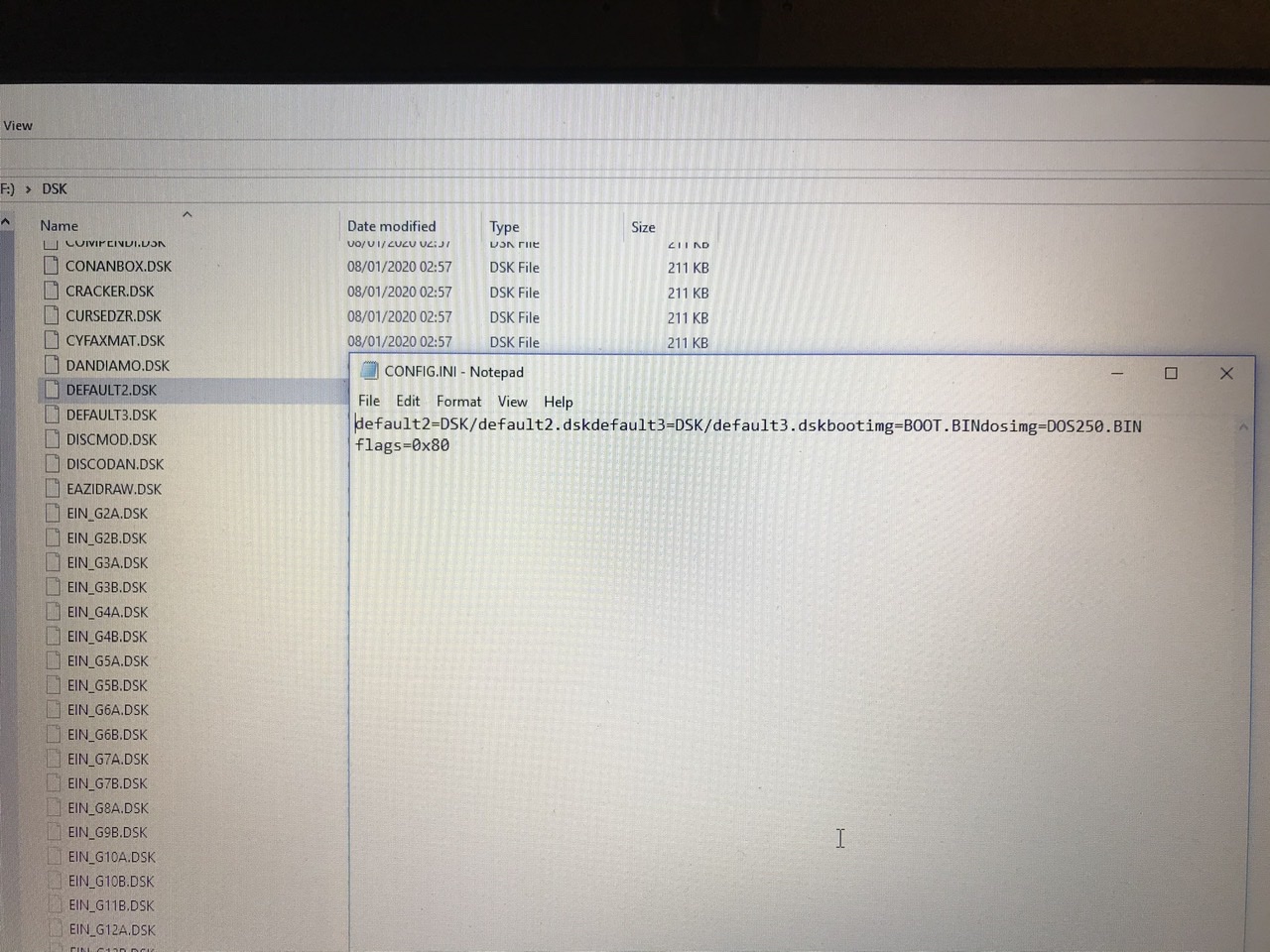

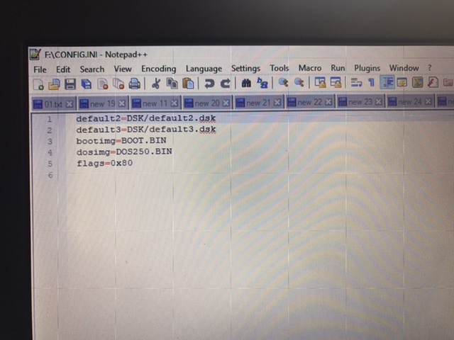

Re: einSDein troubleshooting
I wondered if the sd card was being corrupted. Can you check the config.ini file and see what drives are mounted? Do the configuration options point to valid files on the sd card??
Hmm that looks fine. @lardo - can you open file in wordpad to see if the carriage returns are present? I'm sure they are but nopepad makes a hash of non-windows line endings.
