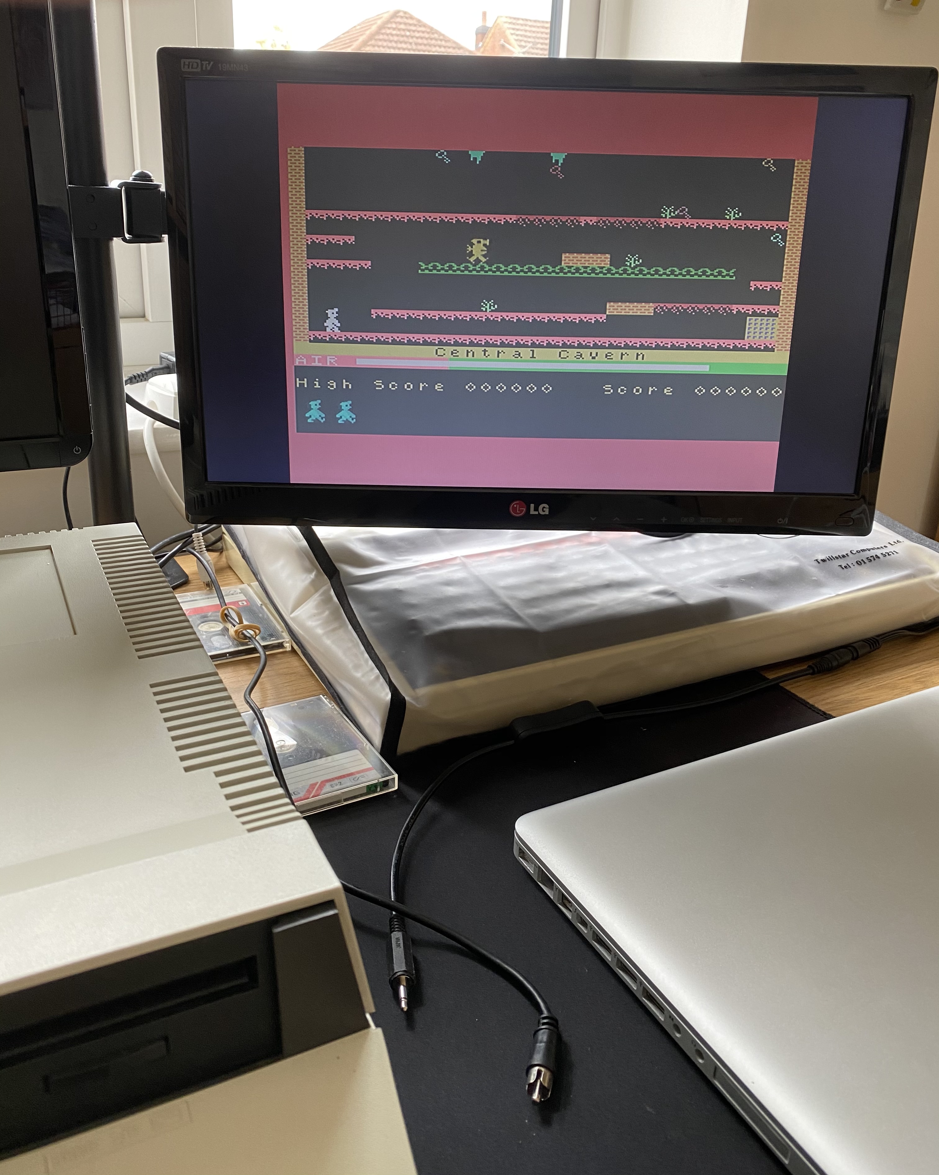

I dug up a spare beeb SCART from Retrocomputershack, changed the internal jumpers in the TC01, added 5volts to the socket (just spring clipped wires for now) and gave it a go.
I only got a black screen (not a surprise based on earlier posts).

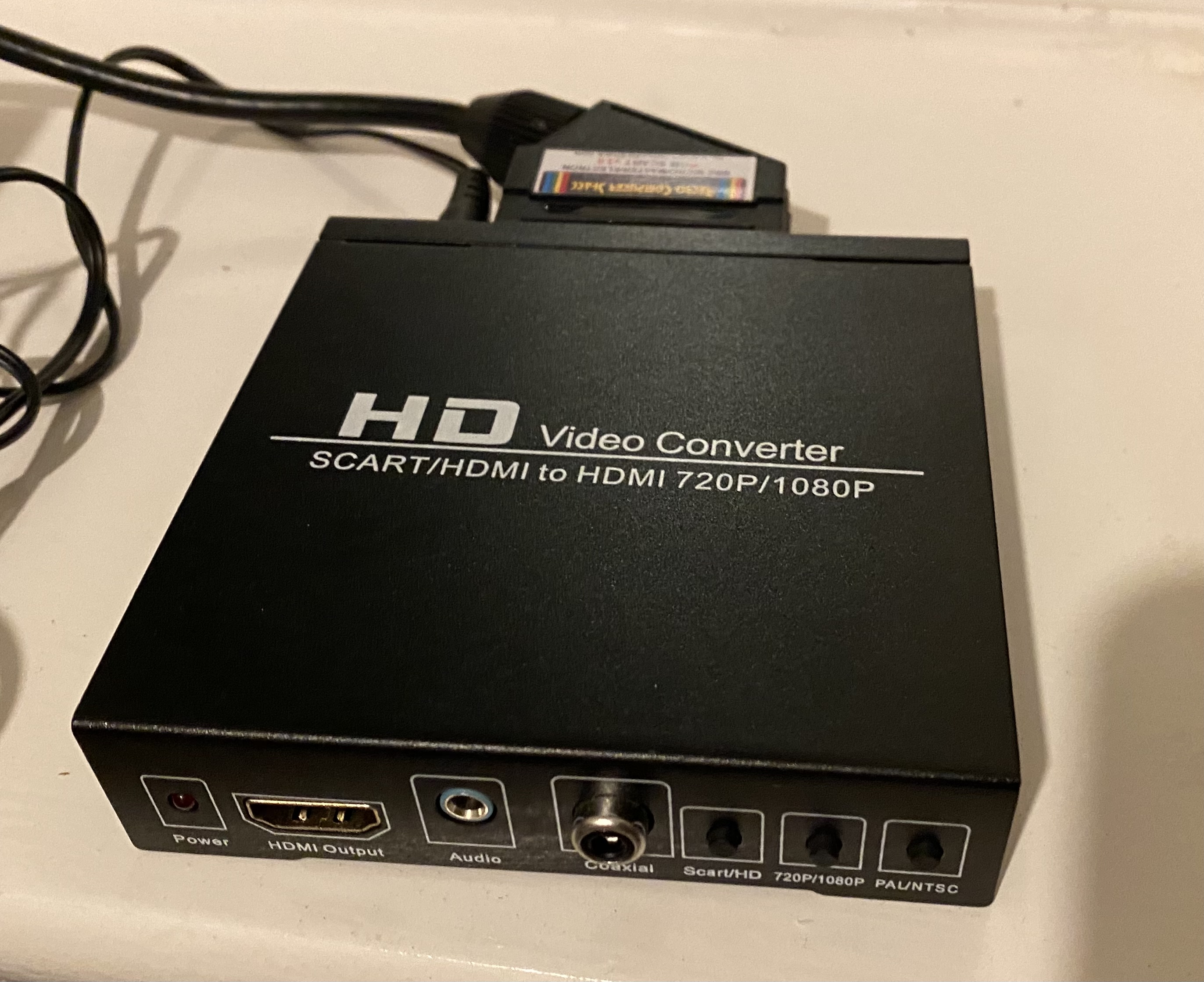

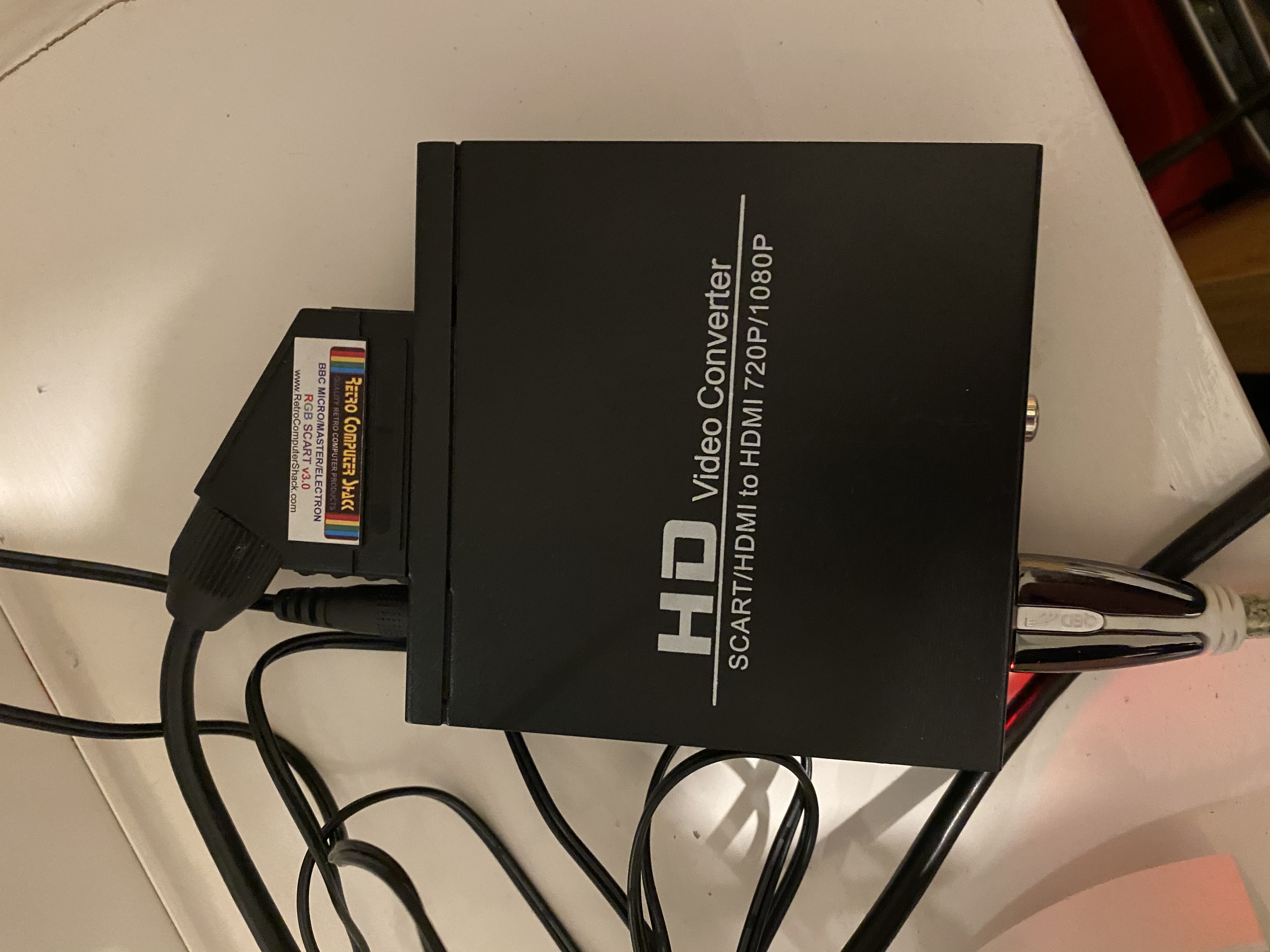

However I do have a HDMI converter box so I thought I would give that a go - it is quite forgiving on signal quality.
Superb picture! I think maybe one column of pixels is being chopped off but I still need to play with the aspect ratio settings etc.
Its just a cheapo upscaler:

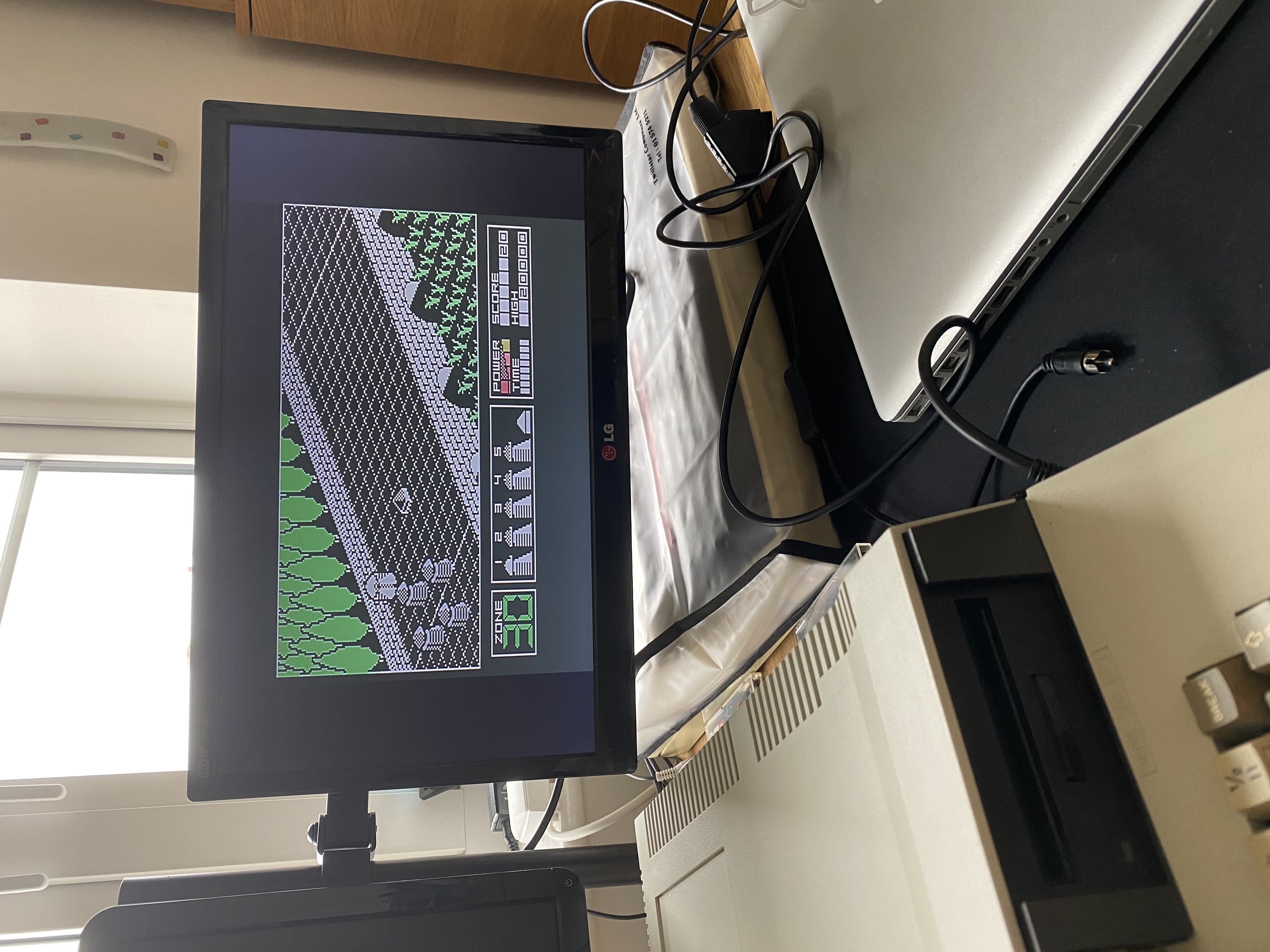

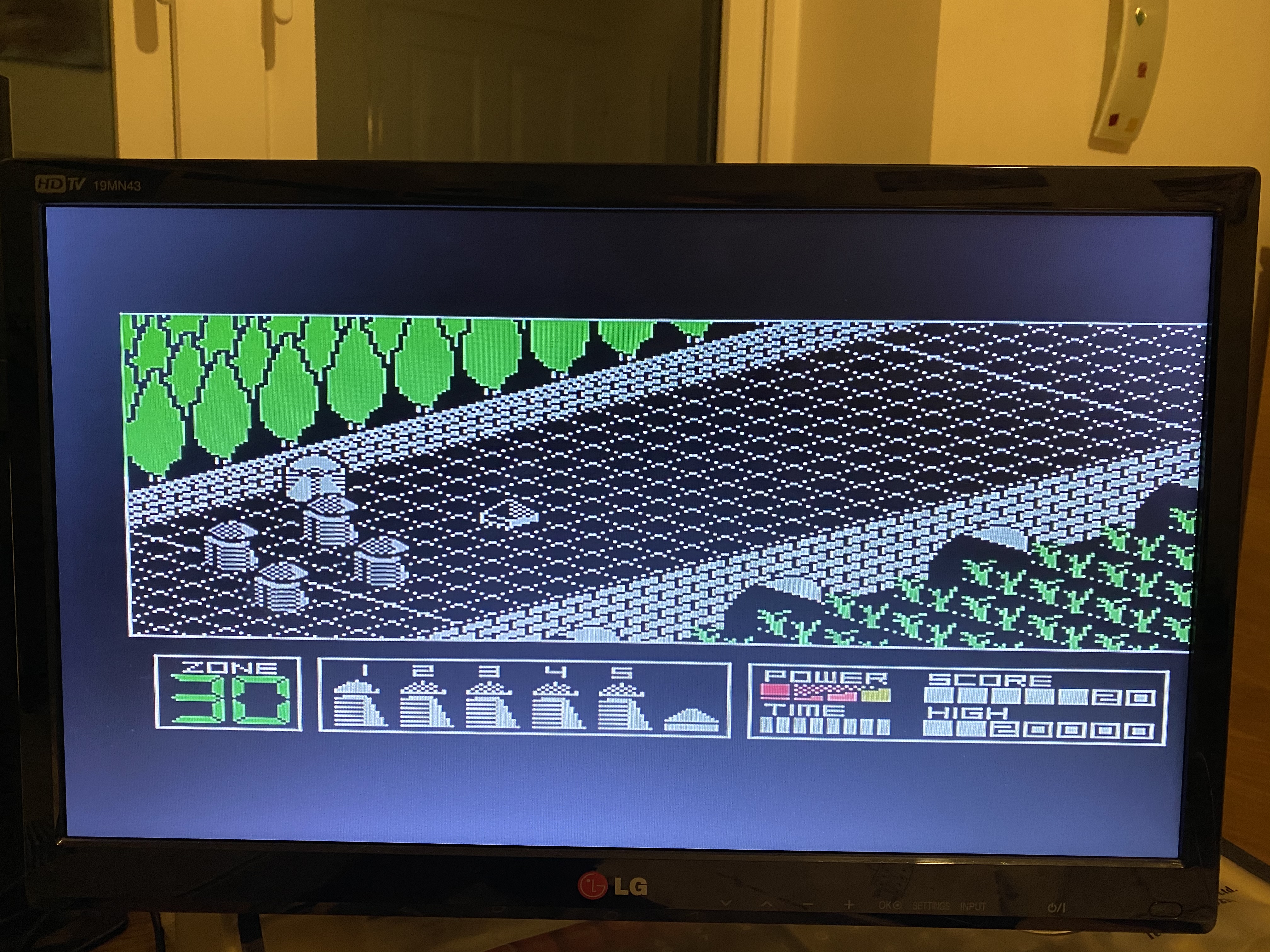

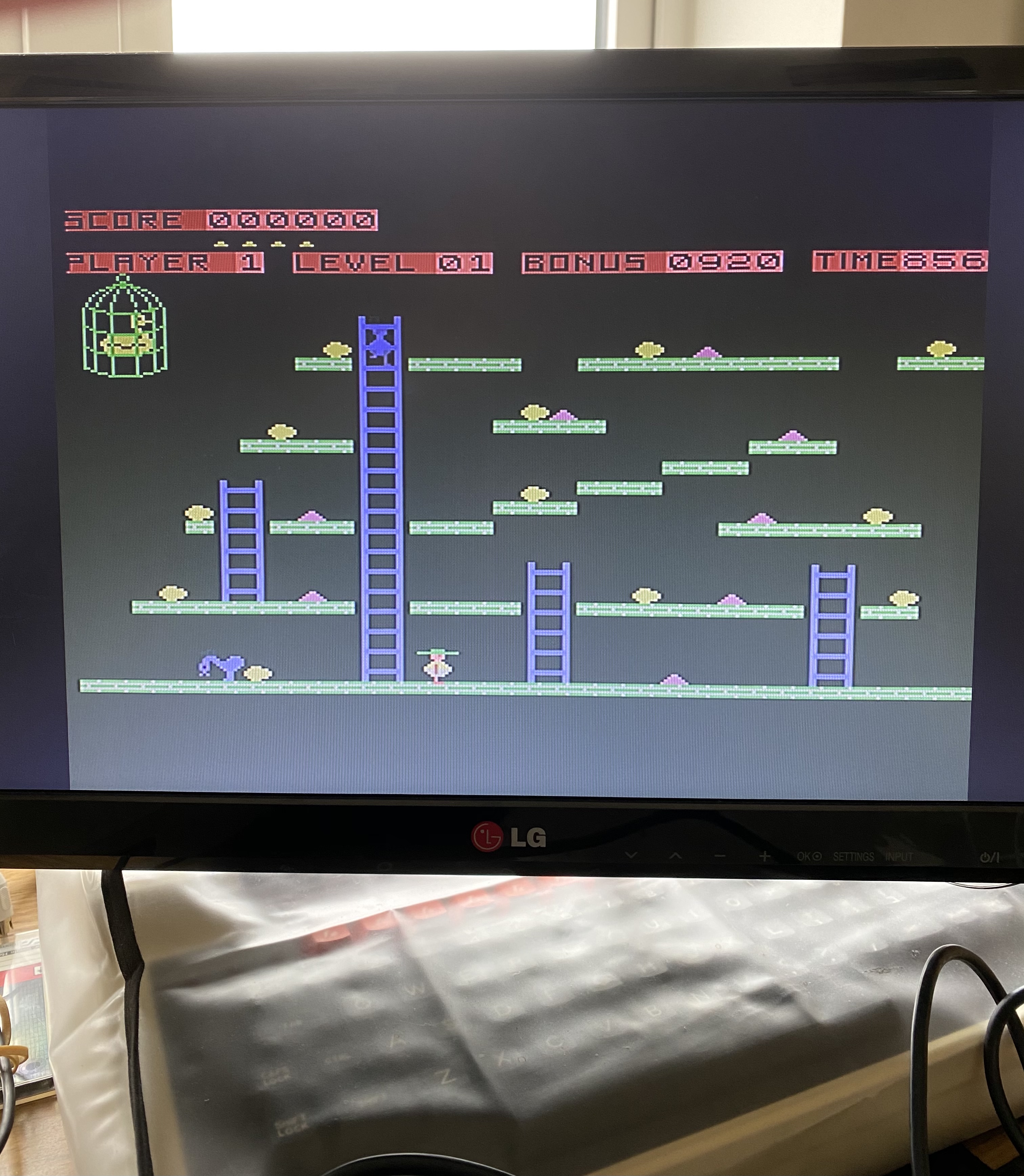

I had previously plugged the SCART into a splitter (as it saves wear and tear on the socket) so in the spirit of adventure I tried the Retrocomputershack cable directly in the LCD telly and it works a treat! Correct aspect ratio as well. 8-)
The picture is rather good.
If anyone has tried and not got a picture it may be worth trying multiple TVs?
