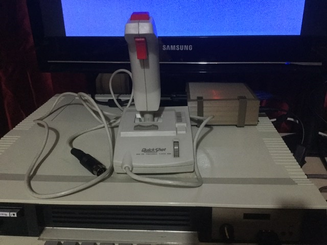

Found the information I needed works great
- Attachments
- Rewired PC Joystick
- E6552DFC-CFC5-4ABE-8BF1-816048D0736F.jpeg (72.1 KiB) Viewed 56326 times

No the pc joystick is rewired with a 7 pin din no adapter needed

No I just rewired the potentiometers
Channel 0 and 1 go to the wipes then signal ground and 0v to one side and voltage reference to the other
Can’t do a diagram as different makes use slightly different wiring
Once you’ve rewired the pots you can fit the seven pin din
Hope this helps
