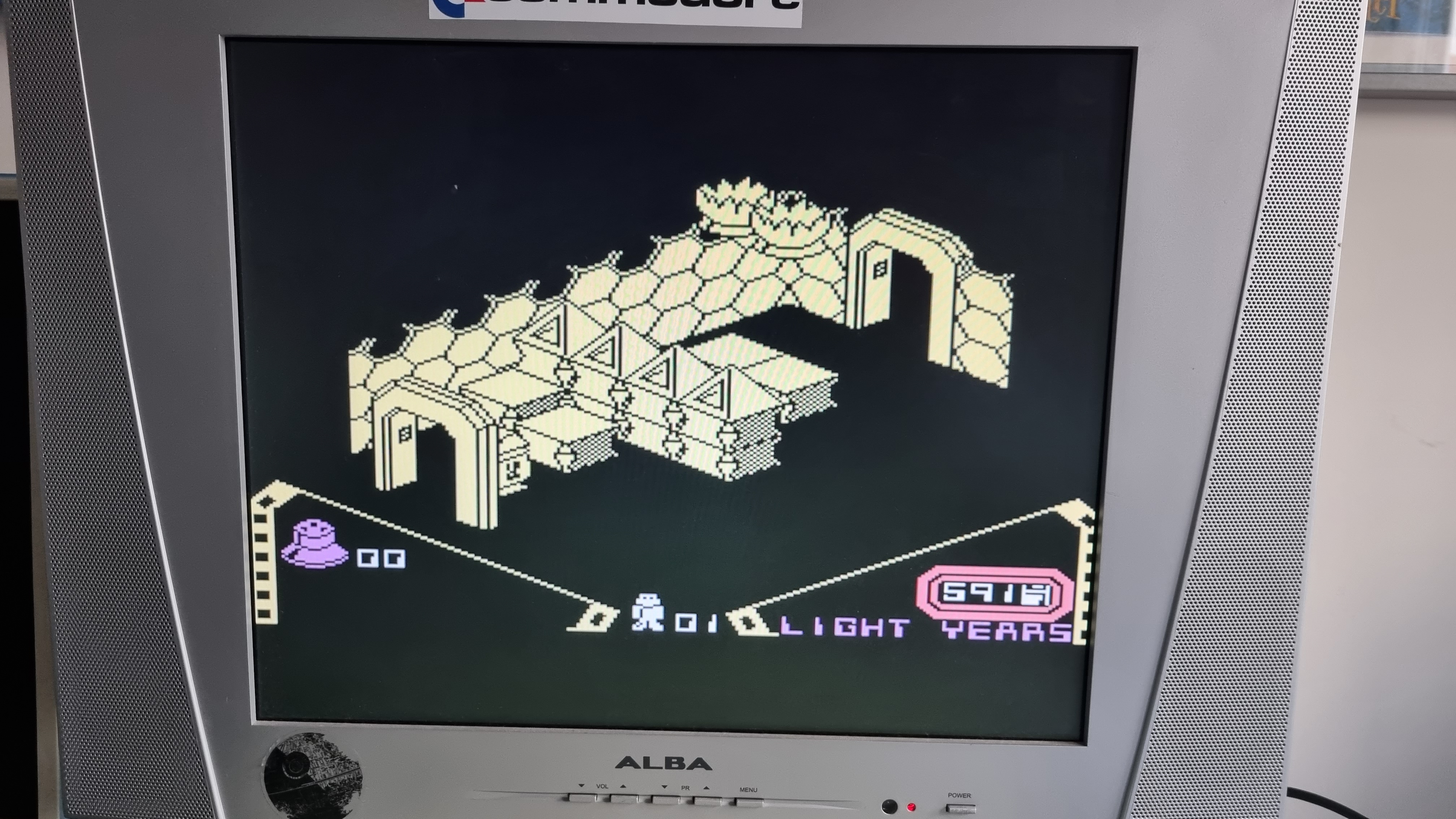

I fired up albert this morning, to test the Oki printer that I had to repair and I am getting a grey screen instead of the normal blue.
A bit of searching reveales that it is transistor Q0001 and it will need to be replaced. (Found this in an old document i have on my server)
Ho Hum. I guess storing machines in the loft, even boxed can cause issues.

Oh well. i need to remove the main board anyway at some stage as I have a video stabilising circuit to fit and want to add RGB to scart which need the 5V mod to the RGB port from analogue port 1.
Hopefully will get some time before Chritmas to get all this done!
Re: Fade to grey
Quick update on this old post.
I have added the customised video circuit that I got in a haul a while ago and the grey screen has gone away. Yay!
Back to the normal blue background now with a 5v feed to the middle pin on the RGB socket too.
Trying to get a scart cable sorted, but can run off the RF now without it being in black and white :D
Re: Fade to grey
RGB to Scart cable complete and working well.
Such an improvement over the uhf signal
